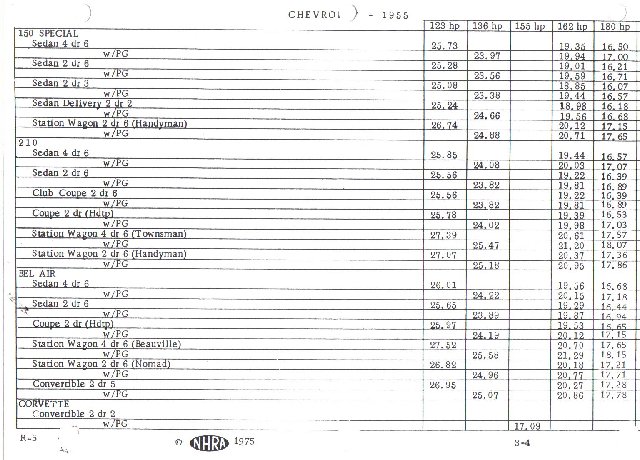

Here is the class page from the red book with the date 1975
Name:	Class Guide for 1955 Chevy Year 1975.jpg
Tony Janes 7941 STK, SS
