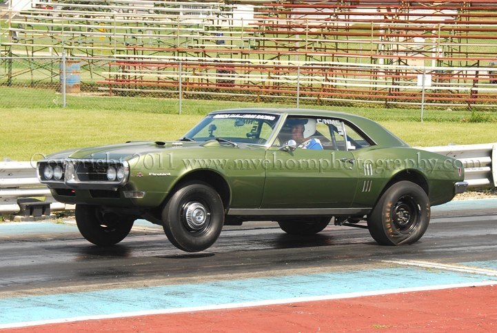

I have multi leafs on my car... the Caltracs were definitely the best $ ever spent ... no slide a links for me... no need for the "shock" deal...
