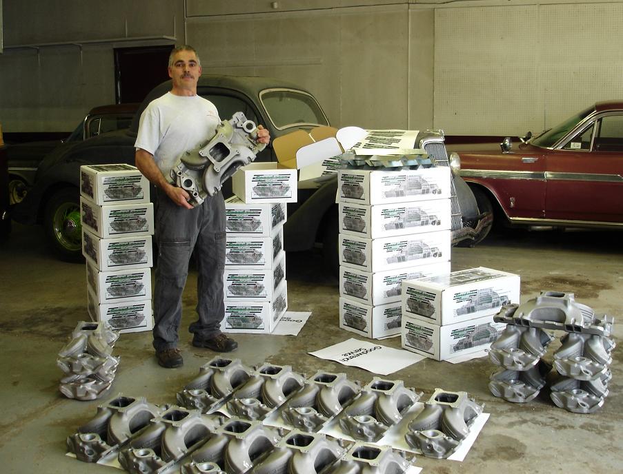

Well.. I didn't get the transmission ordered on time for Mission Instead, went on the big European cruise ship, and another 7 days in Italy. hey... wasn't so bad:
( in Venice, view from the dock at our hotel )
Also, I got the first batch of my single plane 4 barrel 348/409 intakes machined and shipped !
So, I'm finally ordering my new Jerico this week. Looks like I'll go with the 3.19 first gear, running with the theory that I can launch at a lower RPM, and use the engine and the light flywheel to accelerate the car.
Thank you again, for all the help
