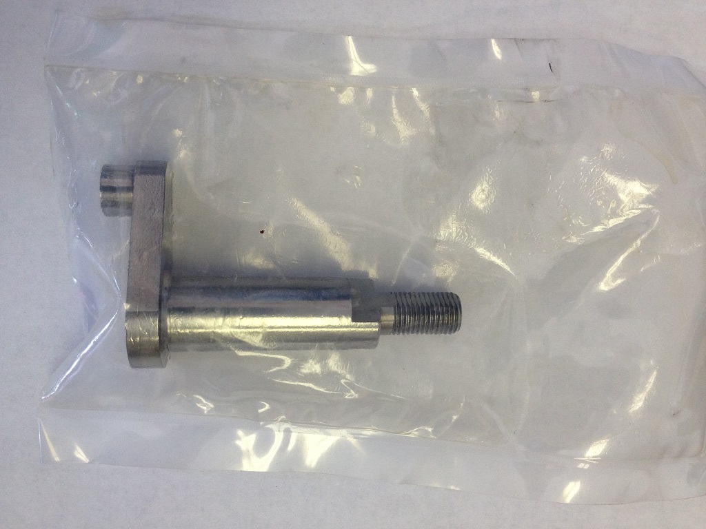

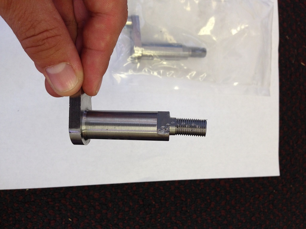

Liked 4,379 Times in 502 Posts
Default Re: Anyone have a shift finger for Jerico?
One new finger in bag, the other we tried to break in the flat where the threads start since that is where they always seem to break. We used a big wrench with a pipe attached, tried adding heat also and that did not work either.. got it to bend a little bit.

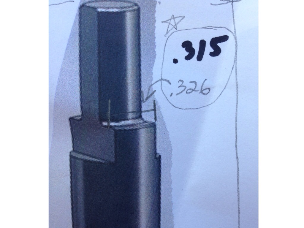

My only concern before ordering a bunch of these is the measurement of the flat area where the shift lever straddles the finger on the outside of the case. I have seen measurements of this area anywhere from .315-.326 on the five fingers I measured today. I would like to settle on a number with a little help from my fellow stick racers. I think I would rather have that be too big than too small and have play in the lever.
