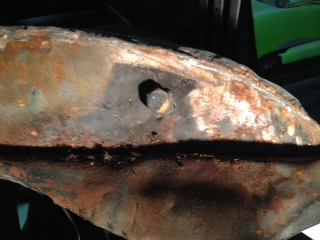

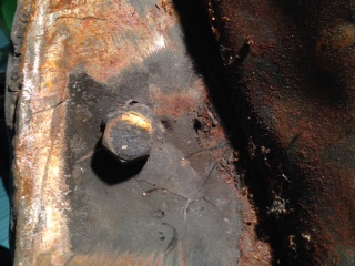

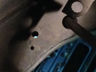

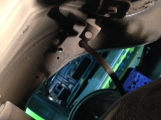

We started working on the Charlie Allen dart again today and found something very interesting. As we were cutting out the after market wheel tubs we found a bolt that ran through the frame rail that we knew did not belong. We did not know what it was for and looked at our copy of american rodding from 1969 which has an article on this car. It turns out Charlie relocated the shocked to the front of the rear and mounted them vertical to reduce wheel hop. I feel it just helps to prove that this is really his dart because who does that kind of stuff.
Here are a few pictures

I noticed in one of your pics that the PS inner shock tower has been modified. pretty good tell tell sign there was a Hemi in it at one time.

The dart was converted to a pro stock car in 70 or 71 and they changed the dash on it so the original vin tag is missing. It does have front and rear torque boxes. The K member is the original big block k member but has been heavily modified for oil pan clearance. When the hemi was in the car it was in with an engine plate.

I forgot to mention that we could see where console brackets were cut off the floor at one time
