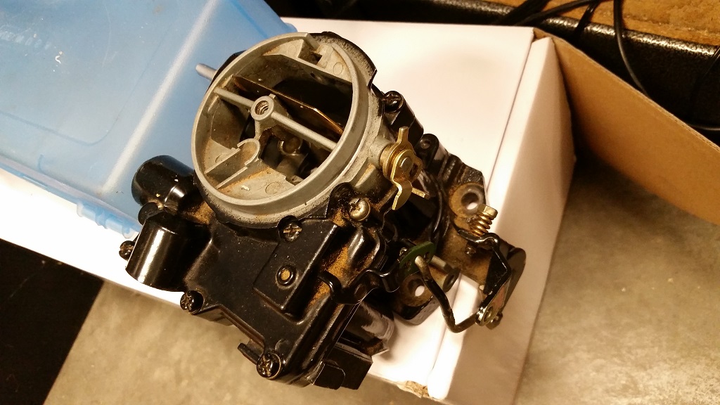

Norm, It is illegal because it leaves machine marks and takes away the anodizing.
That being said, a grungy old core that was dipped in acid to clean it, wouldn't have any anodizing left, if you follow me.
Remember..Any machine marks or sanding scratches visible, and yer out!
I'm not familiar with the Mercury Marine carb.Made by who?
Link? Pic?

Here's a couple of pictures of the marine 2G - it measures 1.375 but it has sleeves in each bore. I've never built one to try yet - one of these days.
Tim
