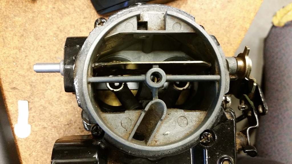

Mark, why is it not legal to perform that process? I didn't think tech. Was looking for the part number any more, if the factory
defined carb. (roch.) meets the dimensional specifications indicated by nhra in the engine specifications for the combination
your running your good !!!!!
Good rochester cores are getting hard to find and the law of supply and demand willkeep the price too high for the sportsman. The flip side of this is maybe nhra needs to consider allowing the mercury marine carb. As a replacement as it meets the large bore rochester dimensions, doesn't require the necessary machining like the roch. To be competative along with
other things.
Just my 2-cent's for today.......norm
NORMAN BARNARD is offline   Reply With Quote
Old 09-30-2015, 06:00 PM   #38
Posts: 7,808
Likes: 2,897
Liked 5,109 Times in 1,947 Posts
Default Re: Rochester 2GC info
Norm, It is illegal because it leaves machine marks and takes away the anodizing.
That being said, a grungy old core that was dipped in acid to clean it, wouldn't have any anodizing left, if you follow me.
Remember..Any machine marks or sanding scratches visible, and yer out!
I'm not familiar with the Mercury Marine carb.Made by who?
Link? Pic?
Old 09-30-2015, 07:08 PM   #39
T Ketels
Join Date: Jul 2005
Location: Dyersville, Iowa
Posts: 52
Here's a couple of pictures of the marine 2G - it measures 1.375 but it has sleeves in each bore. I've never built one to try yet - one of these days.
