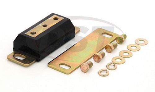

Not bellhousing related but I'm getting ready to re stab the motor and get the trans mounted..... are you guys using any type of trans mount or bolting it directly to the crossmember??
J&S Racing is offline   Reply With Quote
Old 11-19-2017, 11:12 AM   #30
JHeath
JHeath's Avatar
Join Date: Jul 2004
Location: Minneapolis
Posts: 786
Likes: 2,876
Liked 370 Times in 101 Posts
Default Re: Bellhousing
I used a Energy Suspension brand polyurethane transmission mount, Jerico said to use it.
