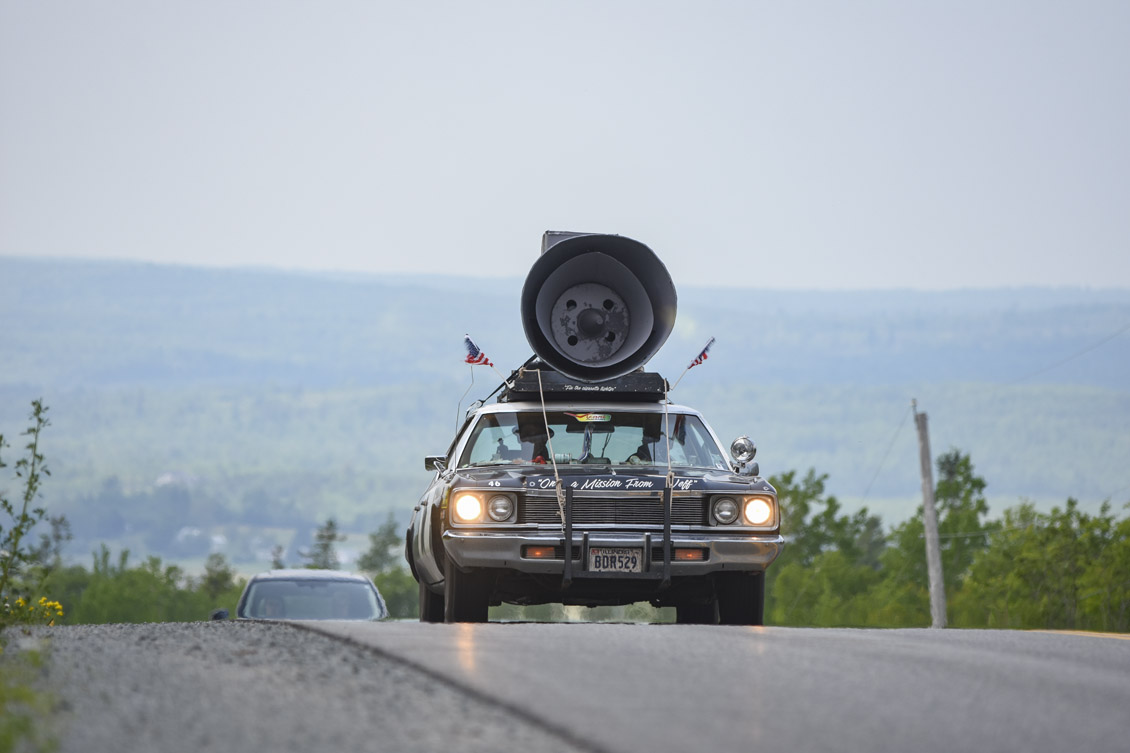

Default Broke down in Halifax on Canada Day
Well, the Bluesmobile made it to the last day of the Great Race. Would not start this morning due to fuel pump failure. IF any racers close by have a generic 12V 3/8 line pump/wire/clamps/hose etc, we could bypass the stock setup. All the stores are closed and we are at the Marriott downtown. I can get it going when the stores open but thought I would ask the racing cloud.....Thanks and have a great holiday. Stephen 337-499-44 three five
