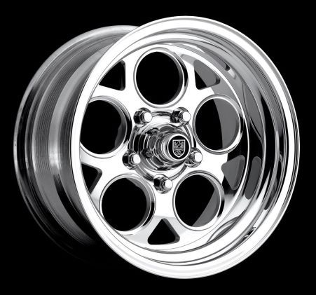

Dan, what rear wheels are you using? -Al
Centerlines !

Centerlines !
Take a look at the back side of the wheel where it mates up to the axle flange. The back of the wheel must be perfectly flat where it mates to the axle flange. My buddy had a set of centerline wheels and the backs were not flat. They had a concave area near the stud holes and he could not keep the lug nuts from coming loose and breaking the studs. He finally had to change the wheels and junk the centerlines. After that no problems with the studs breaking or the lugs loosening up.
Thanks Mike;
Did that, took a straight edge and they are flat.

this may sound stupid but are you using the "correct" lug nuts both either in thread pitch not METRIC on an SAE thread or vice versa as well as the style of nut for that wheel--- IE: cone ,shank etc.?? Weld/Centerline says 85 pounds for most of their wheels with 1/2 inch studs so something is not correct in the application here.Also I would get another torque wrench to tighten them then double check the torque with your wrench see if it clicks at the same rate---FED 387

Do you have the correct lug nuts? If the taper is not right, the lug nut won't seat right.
Do all the lugs loosen up if 85# is used?
They do now !
In fact replaced all the Washers.
Some were deformed.
The new Studs were tightened until they felt snug and seated.
The rears are now at 110# and fronts back at 85#
