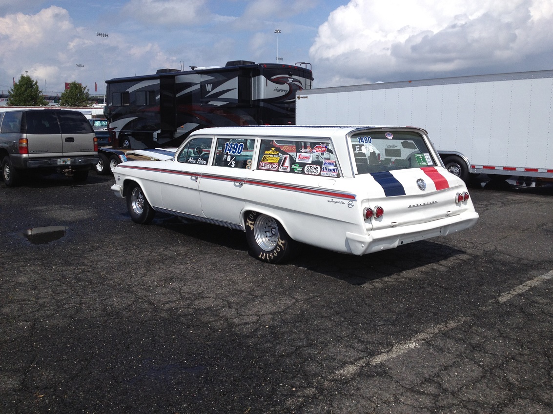

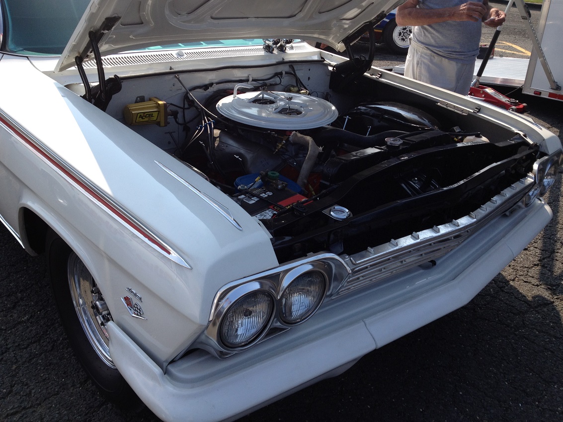

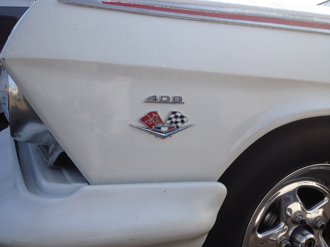

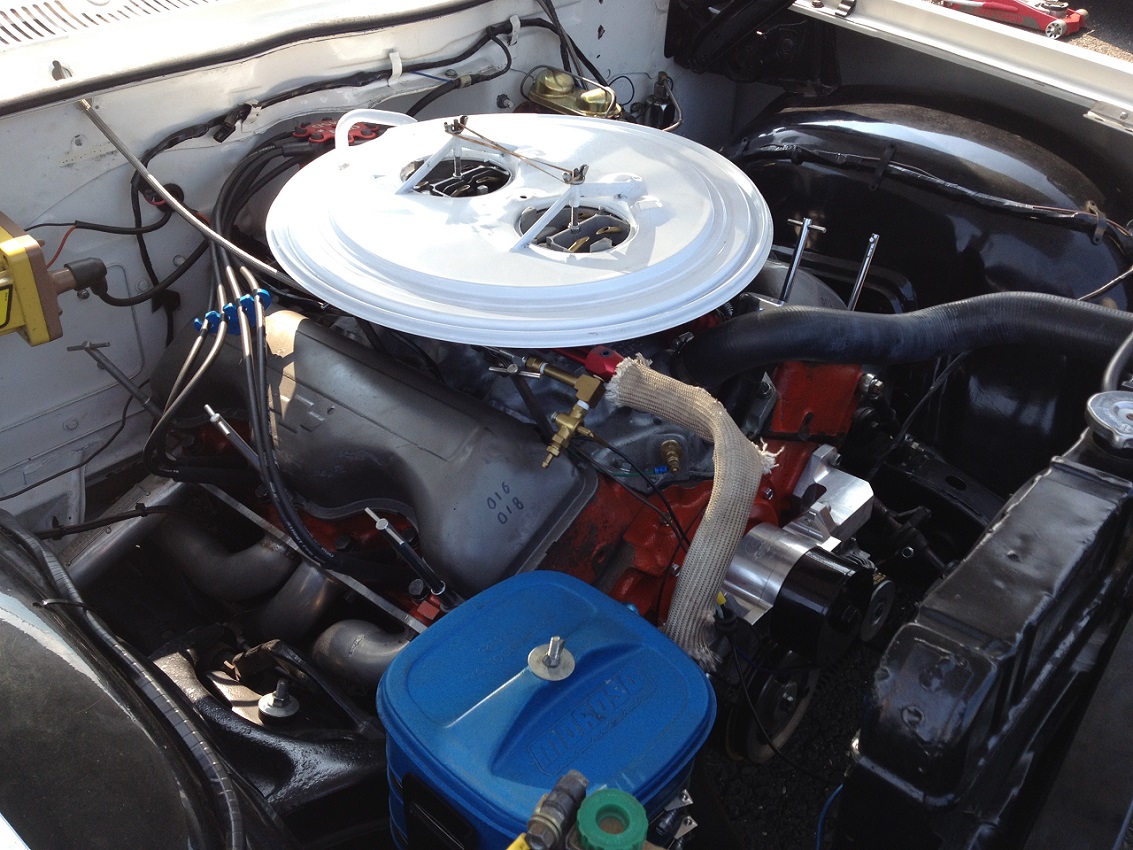

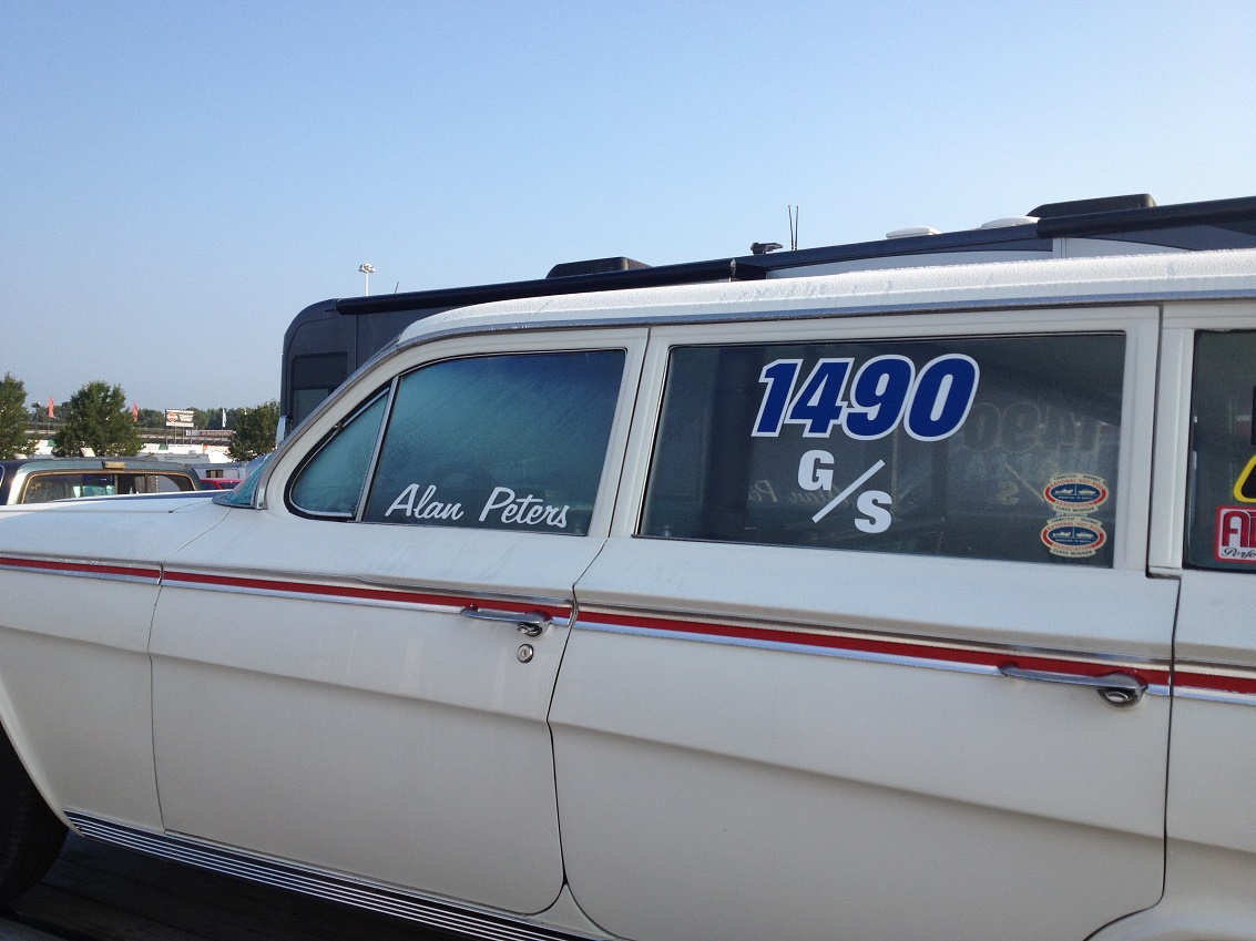

Default Re: Trailer Killers!
Originally Posted by Greg Reimer 7376 View Post
How about a G/S '62 Impala station wagon, 380 horse 409, made the 11 pound weight break. Probably would break every thing else, as well. Also, how about a '66 Impala 9 passenger wagon, 283/220 horse in T/SA,4350 with driver. No problem hooking that one up anywhere.
its too bad NHRA won`t help them with horsepower, and they are just about obsolete.I can`t imagine there are enough people who have interest in building them, for it to be a problem. Its a shame. Ray runs the nostalgia series and has fun.

Cool Re: Trailer Killers!
That white '62 is cool, but it has the dual 4 barrel 409 horse engine in it. Must be refactored to get it into G. The 380 horse I was thinking about was the single four barrel hi po engine released in '62 only. 63-65 engines were red at 400 horse at the factory, but the 62 380 was the same engine.
