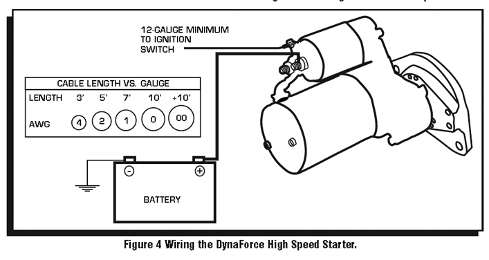

Originally Posted by Eman View Post
That's exactly what Firesale posted, but he also warned at how doing this can cause the starter to stay engaged at times.
Kind of. The starter positive post was always hot and shorted against my steering. Here is the simple wiring diagram from an MSD Dynaforce starter. The one I ran the starter positive through a Ford solenoid. A little too simple.
