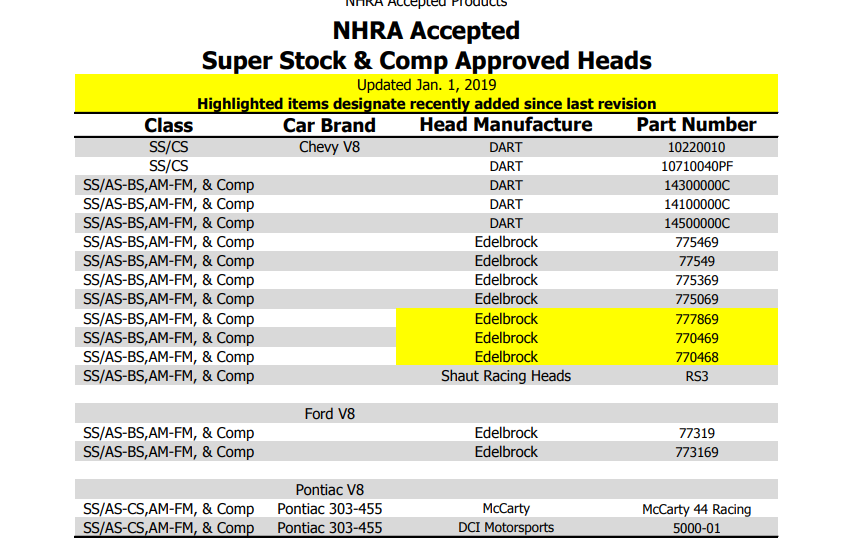

Here is current list of the legal aftermarket heads allowed in the SS/Mod classes.
So whats on here or having a genuine factory part number is whats legal.
Good luck, have fun!

Sorry for any confusion, I missed the Approved, lingo!!
WoW, that 14500000C Dart head is a 9 deg head..
AJ 18 head won't hang with that
Ford boys use the N351 Sportsman head with a 10 degree valve angle. It's not on the list because it's a Ford part number M-6049. n351. It's on the SS/CS record holder.
