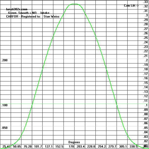

I dug up some old data. This is the lifter raise for a Lunati sticker cam for a 302 Z28 from the mid '70s.Let me add that by the time I got to check the cam it was used.
Stan
