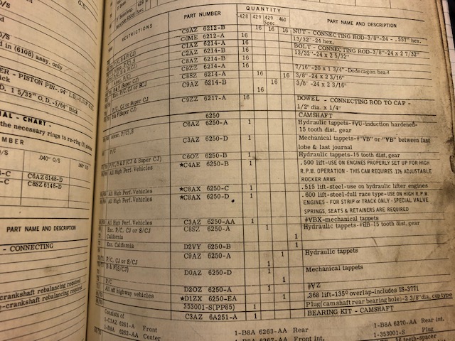

EDIT:
I found the strange .515 lift for C8AX-6250-C.
Here is the page from 1965-72 MPC Master Parts Catalog showing it.
I think the .515 number here is an error, but the point is, it's THERE, so could be easy for it to propagate into a "Blueprint". Still, .515 (assuming 1.73 rockers) is only .524 with 1.76 rockers, not .527. But at least we know the source of the .515 number.

EDIT:
Here is an interesting discussion regarding the C8AX-6250-D camshaft from the guy that designed it.
https://www.fordfe.com/c8ax-6250-d-r...s-t164022.html
