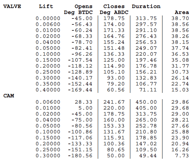

That graph is based on numbers I got using a degree wheel and dial indicator. Not only was that cam raced but it also had a number of miles put on it from street diving. The car / cam was not mine. I just got to work on it. This was in the early / mid '70s. So not sure how this cam relates to the late '60s. At this time a similar engine / car from the same build ran in the high 11's. I don't remember what this car ran.
These numbers are from from the Chevy cam which someone got from a Cam Doctor and was nice enough to share with me many years ago.
Stan
