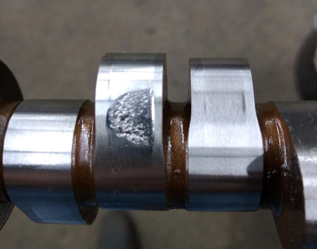

Originally Posted by nolongerracing View Post
I don't know what the answer is, but it's not a roller cam!!!
I think that we all know the "answer". Some people on here just want to change the "question"!
Looking at the photograph of damage to the cam lobe makes me ask one question. What brand/type of oil was used in this engine?
The reason why I ask is my new 350 engine had about 30 runs on it and began to run slower and slower. I checked the leak down and one hole had 40%. I sent the engine back to my engine builder. It was discovered that all 8 pistons were ruined, along with the tool steel lifters. I always used Joe Gibbs oil and never had any problems. Gibbs oil was sold and manufactured under the name of DRIVEN oil. Samples of the used oil were sent in for testing. The results have not been received yet. Has anyone had issues using DRIVEN oil?
John Duzac D/S 4448 STK
