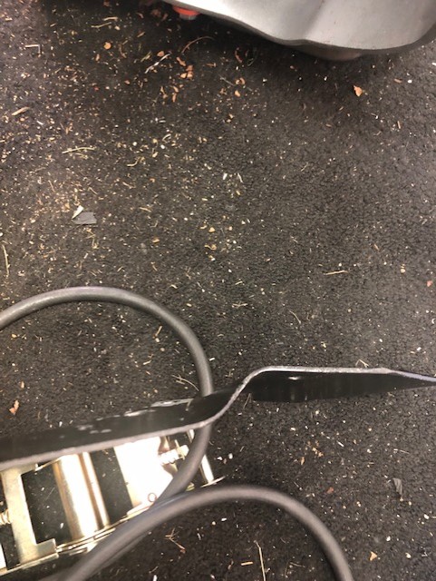

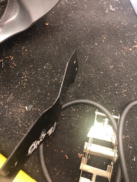

Thanks Phil. I have 1" chromoly tube limiters with rod ends on both sides of the engine.
Here are photos of the bends.
Somehow, it's allowing the engine/trans to still move. Had a dragster once that would bend the plate with only 2 inches between the block and side rail - the limiters were on the frame rail which would move on launch. Moved the limiters to a tubing junction and the movement went away. Can't allow movement if it's placed correctly. Chassis twist, or flex, may be doing it. That's kinda ugly.
I had a couple of hard landings at the hit, which most likely caused the bend or at least contributed to it. The aluminum front motor plate didn't show any signs of stress.
I do a lot of welding and fabrication. If the steel was sourced offshore, then it's not ideal. That's not to say that domestic steel wouldn't have bent, but I doubt it would have to the degree seen in the photos. All of the offshore steel that I have used is substandard at best. You can tell immediately when you hit it with the tig torch.

Can't argue about quality of the steel, I agree. But, if the front (with any material) isn't bending, then it leads me to wonder if the rear is moving up or down (instead of fore and aft) on the hard landings - crossmember possibly flexing would sort of "pivot" on the front support and help to bend the midplate?
Tossing ideas out here because if nothing is moving, nothing can bend, I don't care what material it's constructed from.
That's true. I haven't had any problems since welding two mid-plates together, but I'm going over the suspension before getting out this year to see if anything is binding or moving around.
