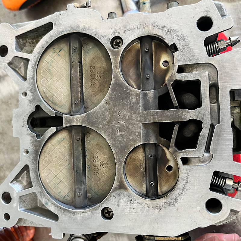

Here are a couple before and afters of John Cira’s Quadrajet.

Ryan Competition Carburetors
