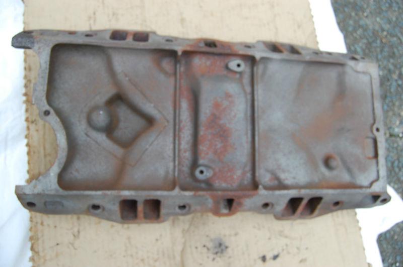

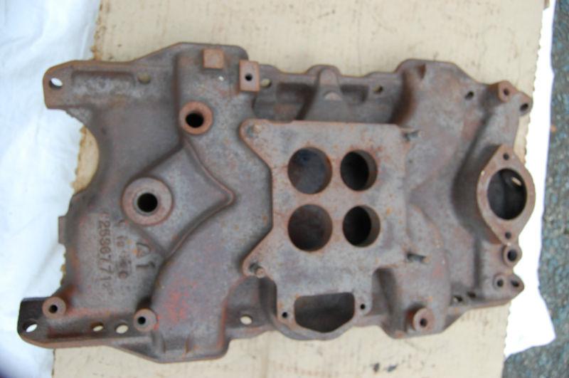

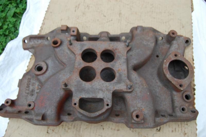

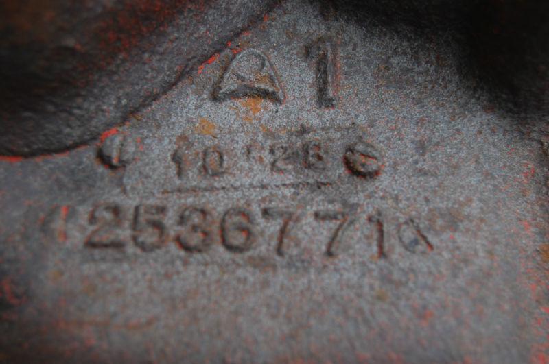

D-Darts had factory modified (intake openings bored out to accept Holley) standard 273 intakes. AND adapter plates.
The D-Dart intake manifold, P/N 2536771, is identical to the 318 marine engine intake.
It's a single plane cast iron intake with an adapter for the Holley carburetor.
771 is also listed as 66 California.

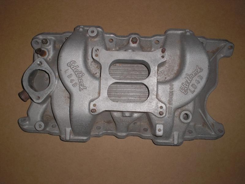

The LD4B Edelbrock intake was approved as a replacement for the 273 due to the fact it was available with a Chrysler part number. The same rationale used on the 440 Chrysler 6-Pack engine with the Edelbrock intake. The 6-Pack intake was available in both aluminum and cast iron.
Looks like it would flow better than that boat anchor.
