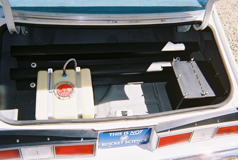

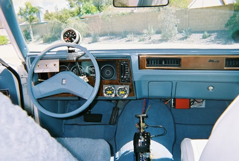

Torn down at Indy. Not a problem:
Notice what looks like full heater controls. Again ,it's all an illusion.
There's a few pounds back there .
A few pounds out here, a few there, pretty soon inside your trunk will look look this:
