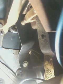

Thanks. Also, a buddy told me that Quarter Max sells a U shaped bracket that can be installed as a secondary safety measure to ensure the brake pedal pushrod cannot fall out/down. Any info on that is appreciated.

Thanks. Also, a buddy told me that Quarter Max sells a U shaped bracket that can be installed as a secondary safety measure to ensuer on the bottom e the brake pedal pushrod cannot fall out/down. Any info on that is appreciated.
We made ours, its just a "Z" shaped piece of metal with a hole drilled thru it for the pushrod on the top flat, another on the bottom to bolt it to the firewall.
Took all of ten minutes to make
This is what we made. Was taken from a cell phone.
