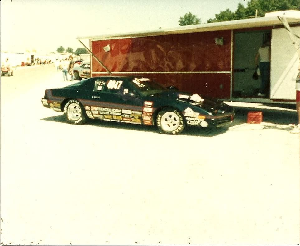

the late Bob Wollett ran iron dukes in both the old Kathy's Clown Firebird he got from Stover and his new olds he raced before retiring. I know his son Jason has everything still. I have not talked to him since Bob passed away to see what he is going to do with everything.

Jason still has the cars and wants to race them someday. He has NO plans on selling them.http://i256.photobucket.com/albums/h...scan0001-2.jpg
