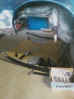

FWIW, a little update. Took out all the old pieces out from under the car. Have forgotten how much "fun" it was removing all those old rusted parts. Pretty much nothing on this vehicle wanted to give it up. That's after spraying everything with liberal doses of PB Blaster!
With all the tools and equipment I have today. This was still a chore. Don't see HOW we did some of the things we did, 30-40 years ago. All I had back then were some hand tools and a couple big hammers. Had the advantage of youth, I reckon.
Good news is, only have to make a couple phone calls, order a few small parts. This can be a quick turn around, the old thing "could" be back on the ground by next weekend.

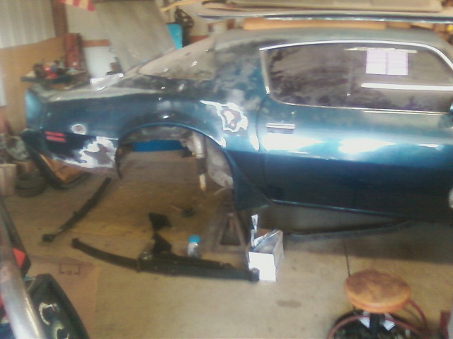

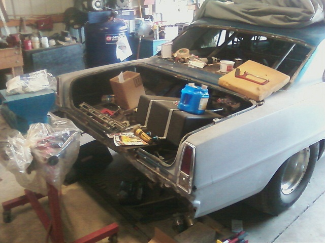

Got a lot of the grime, junk and undercoating off the rear. Going to shoot some paint under there. Then start adding pieces back. Also throwing in a picture of my Chevy II bracket car, lot of work still to be done to it as well.

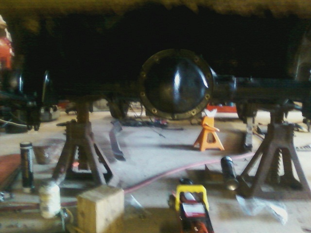

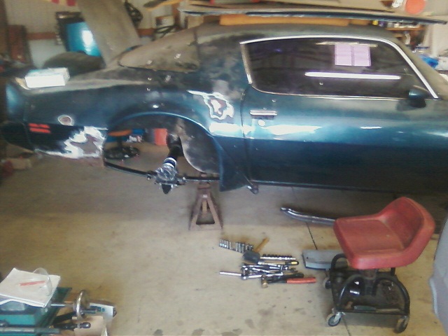

Spent this warm Saturday working on cars. The early part of the day was used to make up a few interior parts for our bracket car. The remainder of the day was devoted to the Firebird. At last a pile of pieces have made it off the floor and onto the car.

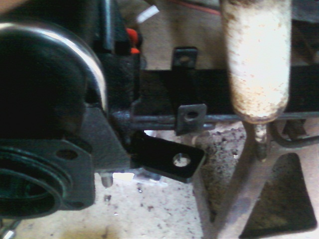

We got the springs under the car. Liberal doses of lithium grease and anti-sieze on all the bushings, sleeves and bolts. The rear end went under the car with very little persuasion. We did have to open up the holes for the U-bolts.
My only concern for the moment, the old car had air shocks under it. After we got the mounting plates under the springs. with the offset shocks of an F-body, the driver side shock falls right into place. The passenger side is another matter. The shock sets in front of the rear end, it hits the bolt head on the bracket that ties the spring together? If anyone has any input, world love to hear it. Will be making a couple calls Tuesday afternoon.
All in all, just happy to be gaining a little progress. Just trying to join the ranks.
