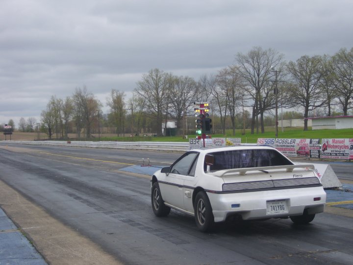

Saw this one day at dragway 42 running mid 17s...

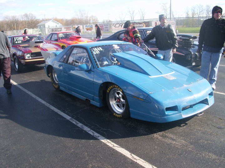

...and this at Norwalk a few years ago at the Halloween Classic.
