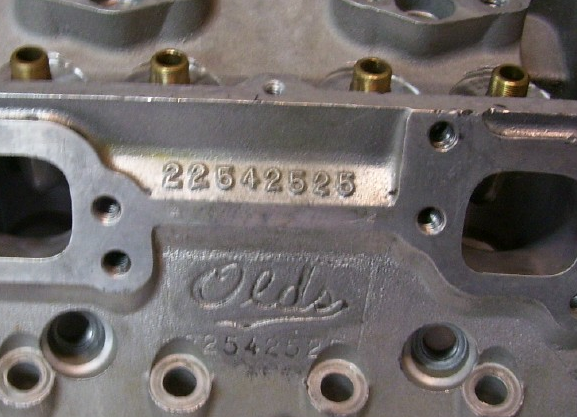

At one time I was thinking about running a set of Olds heads on a SBC (Skoal Bandit era) in SS production. I had sent a picture to Mike Baker and he approved them. They have a GM casting number. See picture.

Adger Smith (Former SS)
