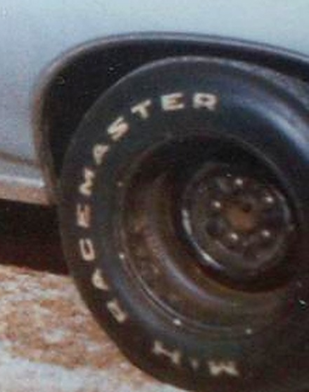

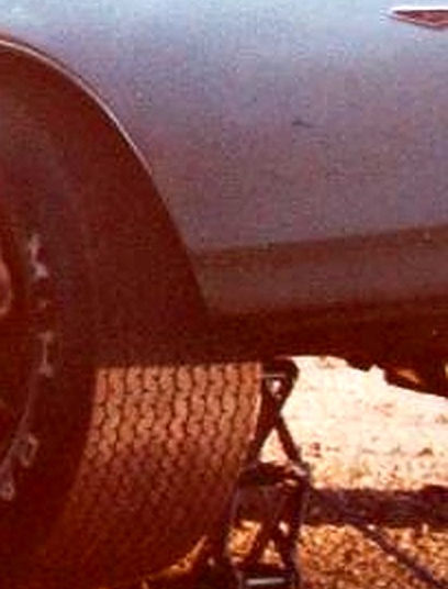

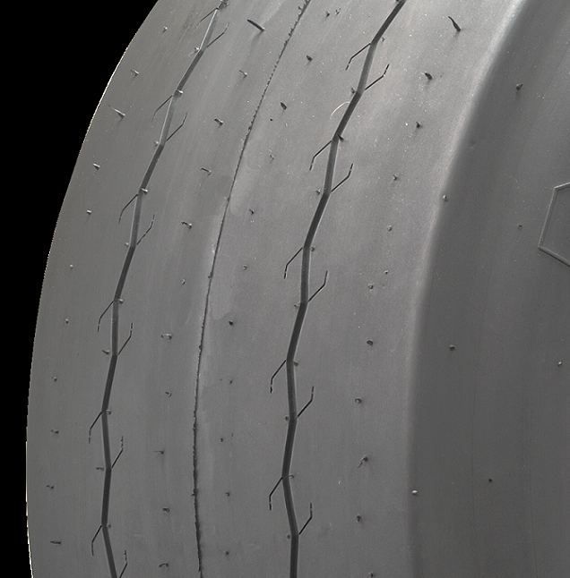

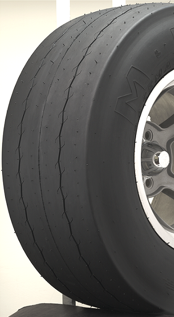

Continuing to comb back thru the Nostalgia section. Since I started racin Stock, @ local tracks, in '73, I MAY be able to add something to this.
In '73, we had to run the DOT tires, as mentioned. Now we're not talkin about the soft compound DOT tires of recent years. I ran M&H Racemaster DOT tires. But they were HARD.
BUT, for '74, we were allowed some M&H tires which I called "cheater slicks". They were basically soft compound wrinkle wall slicks, but with 2 very small grooves. They ended my traction problems & instantly dropped my ET 1/2 sec.
Below are pics of the hard tires I ran in '73, and some pics I pulled up of tires that look exactly like what I remember running in '74. They were a 1-year item only, IIRC. Ran 9" slicks after that. Ran wheel screws in all of 'em. Probably didn't need any with the hard tires.
