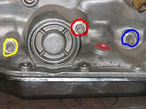

Rear port is main line pressure. You will see pressure here in all gears for most valve body configurations. Some race-only valve bodies may not have pressure at this port or the others Middle port is 2nd gear pressure Front port is third gear pressure

Right side of TH350 case. Pressure ports are circled.
![]() ![]() TH350 pressure ports circled
