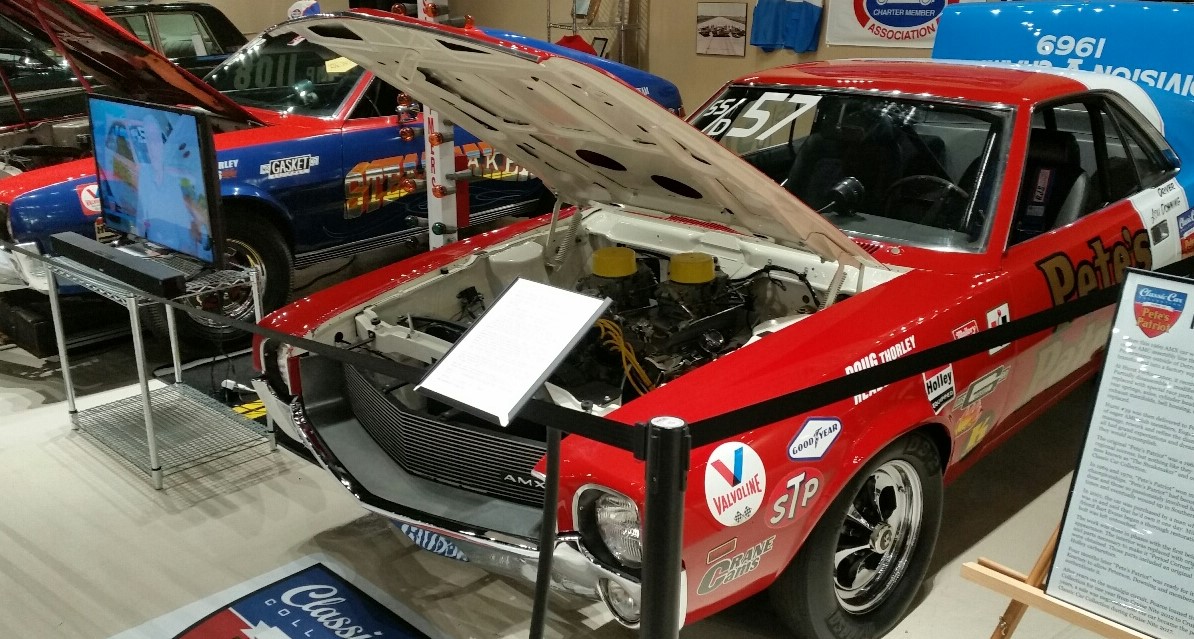

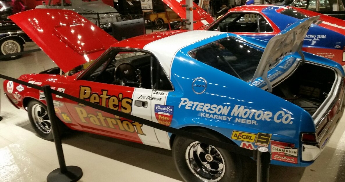

I was in Nebraska last year and went to classic car museum in kearny, there was a real ss/amx petes patriot was display
Also there was a dealership in kearny as well that campaigned several amcs
I will post a couple pictures
