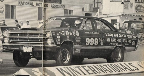

Tough one to find info on:
I'm trying to figure out what combo of 67 Fairlane 427 ran in 1967's SS/C=7.70 lb/hp or 1968's SS/D=7.70 lb/hp.
Don McCain & Donnie Brewer each ran cars in this class & set NHRA records in SS/C 1967 and SS/D 1968 (Same class, different letters).
There's a picture of McCain's car here
1967 Ford Fairlane 66-67 427 Fairlanes picture | SuperMotors.net
Note it shows SS/C on the door paint which I'm guessing is from 1967, and SS/D scribbled for the meet which says "WINTERNATIONALS" so I assume 1968.
Glass hood - those glass hood 8v Fairlanes usually ran a higher class, SS/B=7.00 in 67, SS/C=7.00 in 68.
Schorr's Total Performance book pg142 says McCain's car was a 4v, consistent with what I'm guessing.

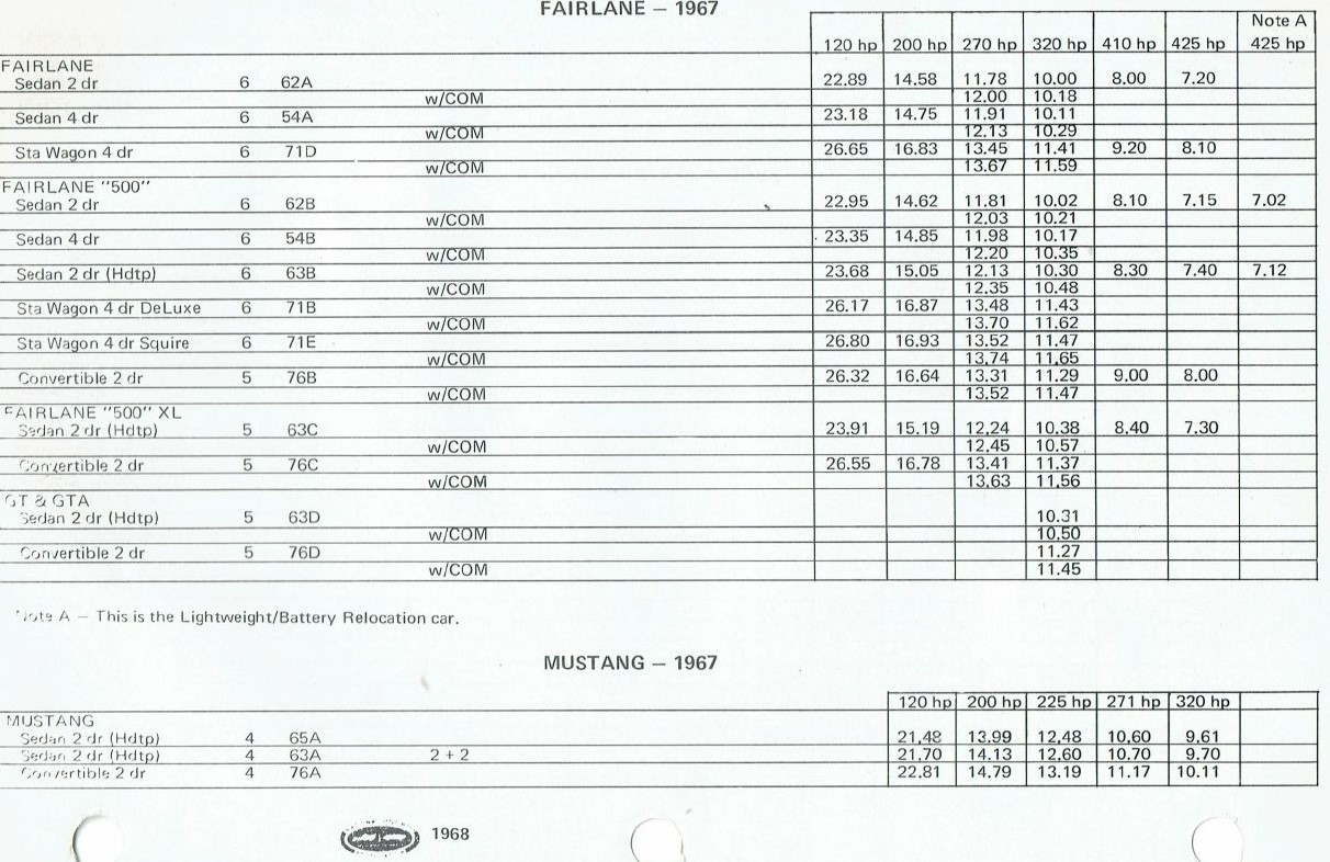

Trouble is:
1. I didnt know the 4bbl + glass hood combo was legal back then.
2 The glass hood + 4bbl is NOT listed in the 1968-70 NHRA guide - the only legal combos are:
4v flat hood
8v flat hood
8v glass hood
The combo seems to disappear after early 1968 which is consistent with what the 1968-70 NHRA sheet says.
I wondered if any of you know what combo McCain or Brewer ran back in 1967 and early 1968.
