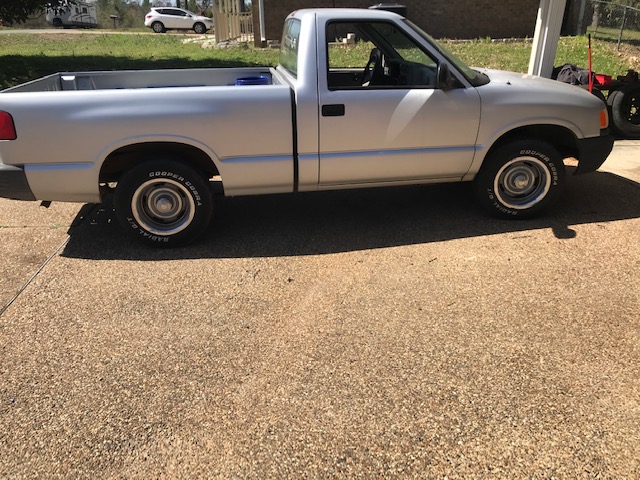

Old 09-08-2023, 03:55 PM   #6
Woodfin
Join Date: Sep 2006
Location: Kilgore TX
Posts: 540
Liked 288 Times in 109 Posts
Default Re: S-10, SBC race header
Trash hauler
ID:	68422   Click image for larger version

It is a special model equipped with Corvette wheels. [which I may keep]
