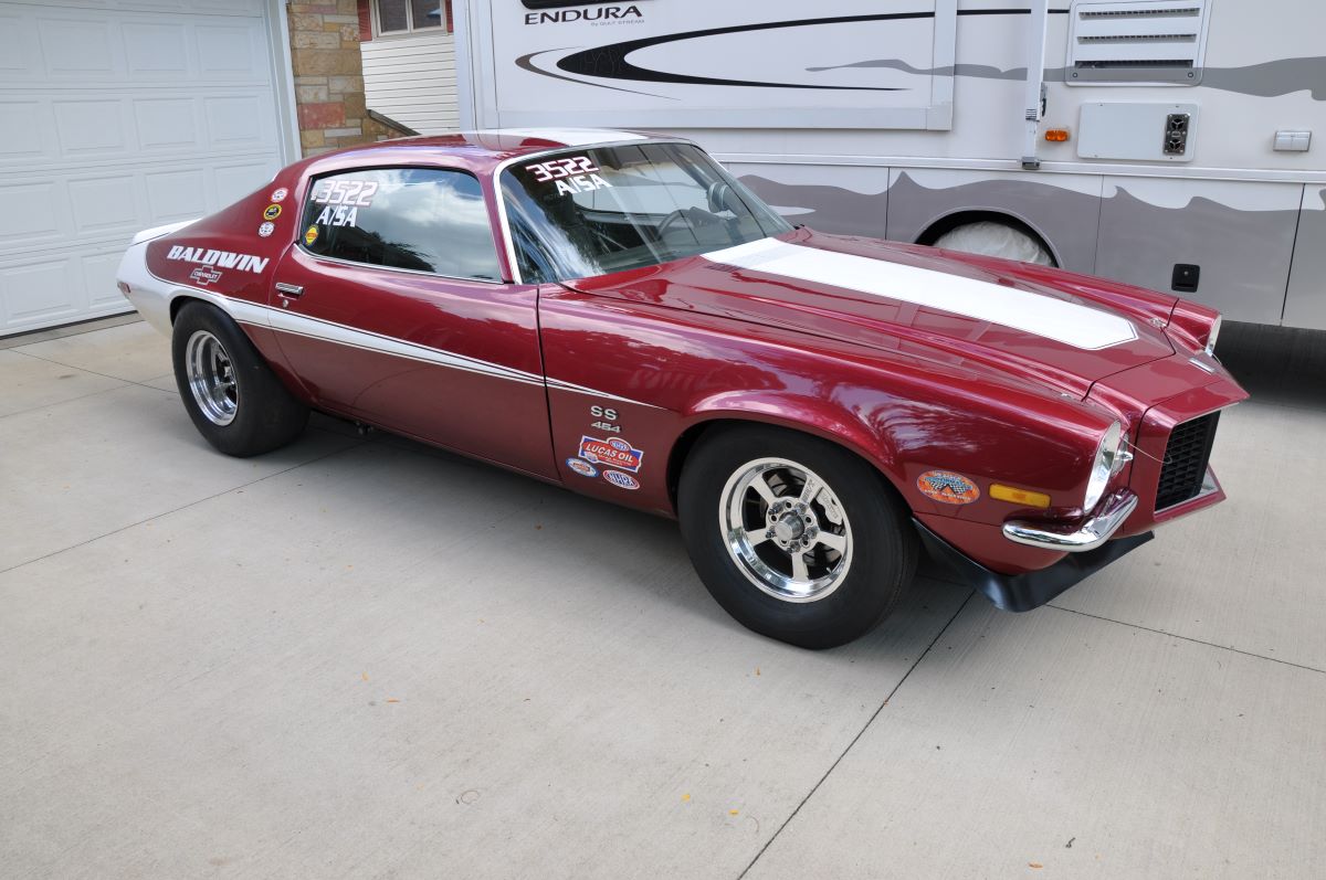

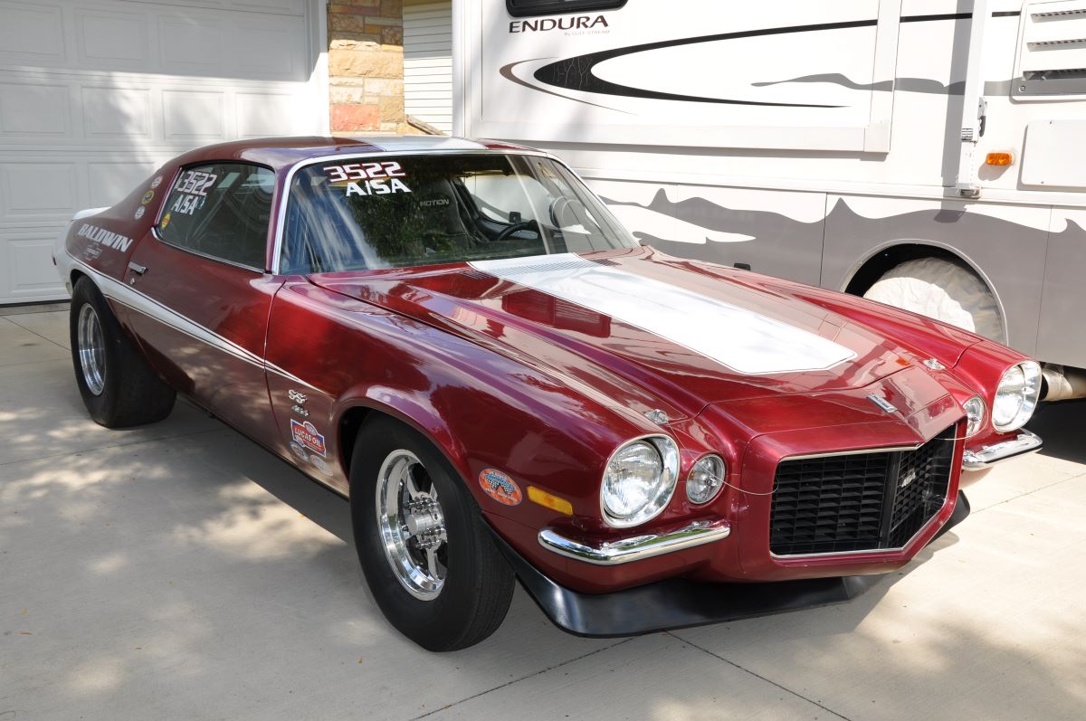

1970 Chevrolet Camaro NHRA Stock Eliminator race car (Baldwin Motion Clone). This car has a 402 CID – 375 HP engine that is rated at 400 horsepower coupled to a Metric 200 automatic transmission and a Strange twelve bolt GM rear end housing. NHRA classifies this car as a natural “B” car.

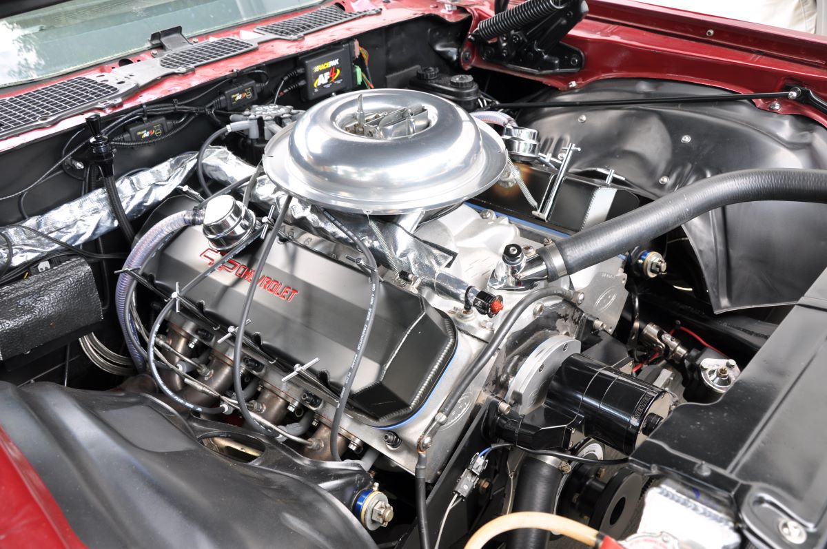

Parts are either genuine Chevrolet or NHRA approved replacement parts legal for Stock Eliminator. Dart Big M Block, Chevrolet forged crankshaft, CP pistons, Carrillo rods, Total Seal rings, Clevite bearings, Moroso oil pan, Gary Hettler Edelbrock NHRA approved aluminum cylinder heads, Chevrolet intake manifold, Jesel rocker arms, PAC valve springs, retainers, and keepers, Trend push rods. Quick Fuel 780 vacuum secondary carburetor, Ridgeway engine diaper, Mezeire HD water pump, aluminum radiator, Moroso 3 quart accusump with electric solenoid switch, Magnaflow 500 fuel pump with integral filter, Aeromotive fuel regulator. Calvin Elston custom stainless steel step headers which were made at his shop on this car coupled with Burns megaphone stainless collectors (including tethers). The most recent machine work on the engine was done by Brian Tilburg of Tilburg Race Engines.

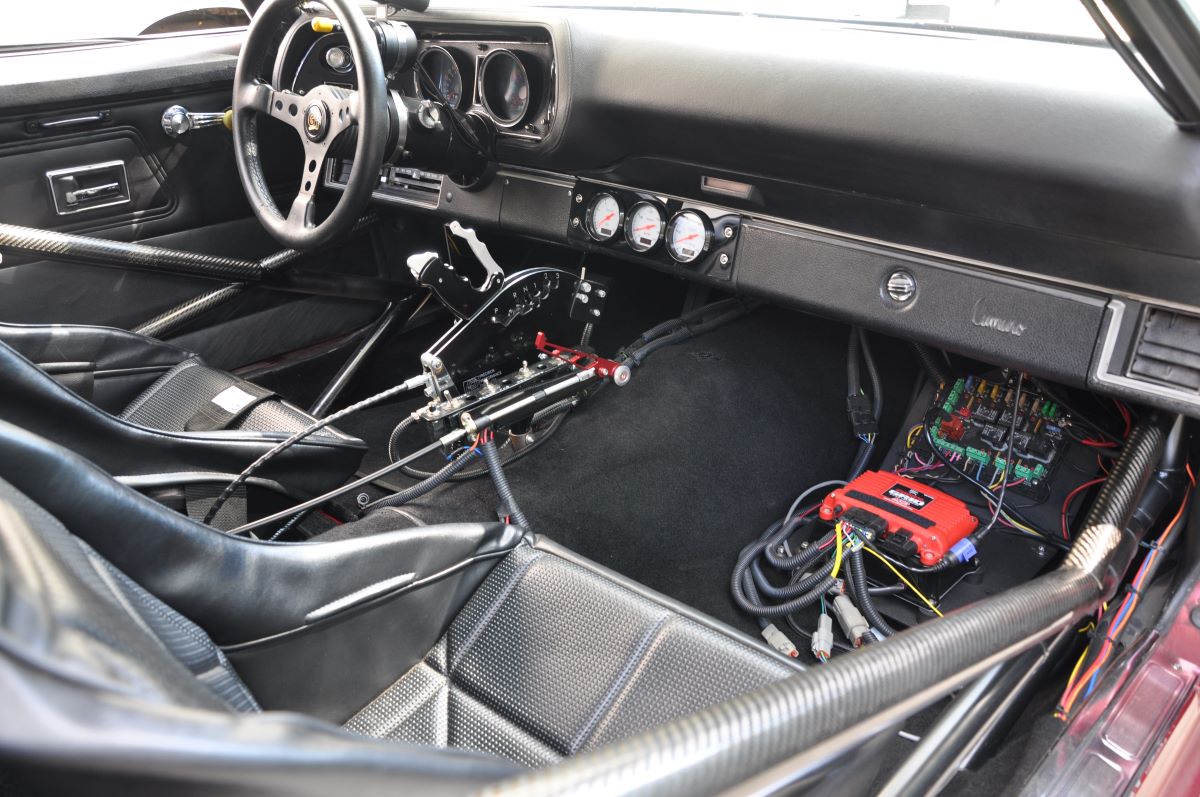

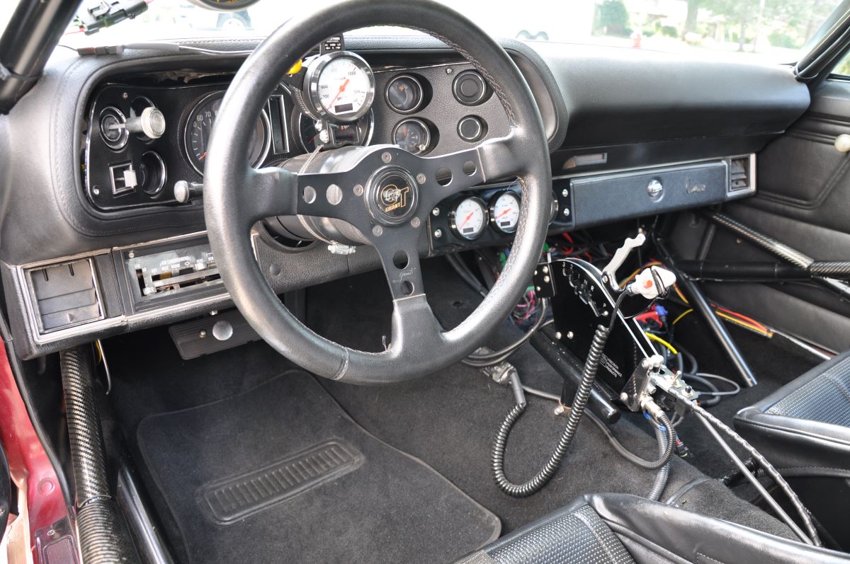

East Coast Auto electric mini alternator and bracketry, K-R wiring system with fuse panel and overhead switch panel, Lokar remote cable for master on-off switch. Racepak Computer with the following channels: Engine RPM, Driveshaft RPM, battery voltage, accelerometer forward and lateral, 8 Oxygen sensors, 8 exhaust temperature sensors, fuel pump pressure, carburetor pressure at regulator, brake pressure, convertor charge pressure, transmission line pressure, engine water temperature, engine oil pressure, MSD ignition timing. Racepak intelli-gauges including, brake pressure, carburetor fuel pressure, oil pressure, and water temperature. Autometer tachometer. Shift light, low oil pressure light, brake pressure light. MSD grid ignition with MSD coil, MSD spark plug wires, and MSD starter. Two 12 volt Altronics lithium batteries, charger included.

Davey Summa – Summa Performance certified chromoly cage to 8.50 ET by NHRA. Stroud cam lock seat belts and Stroud window net. JAZ aluminum racing seats.
