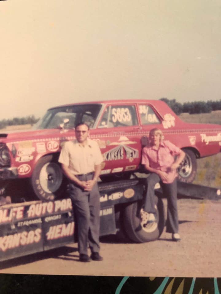

Originally Posted by Dan Bennett View Post
Does anyone have any information about this car? It was for sale at an IHRA Nationals in St Louis back in the mid 70s and I came very close to buying it.
I didn't know enough about those cars at the time to check it out properly so I have no idea if it was a factory car or a home built.
I'm a little late posting on this but I believe John & Dave Wolfe campaigned that car at least until '80 or '81 pretty sure it was a real one. Click image for larger version
