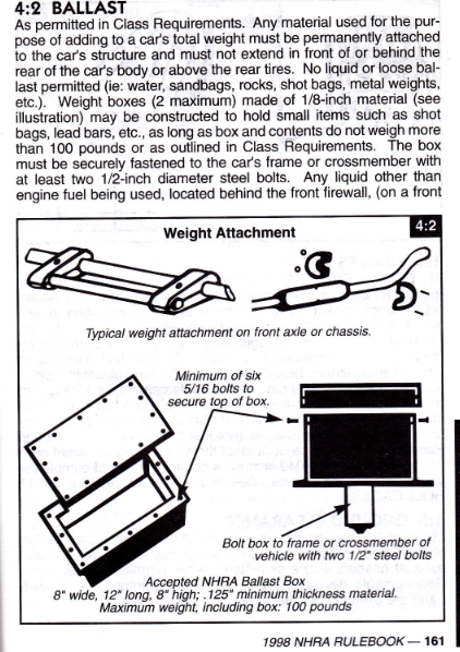

I'm sorry but the rule book 2009 makes no mention of size or number of bolts to hold the top of the box on. I thought it did. Just old age playing a trick.
Larry, you and Billy aren't wrong, this is from 1998 NHRA rule book, that was when I built my 89 Mustang stocker, I made a box with 6 bolts holding the cover on, this isn't in the more recent rule books.

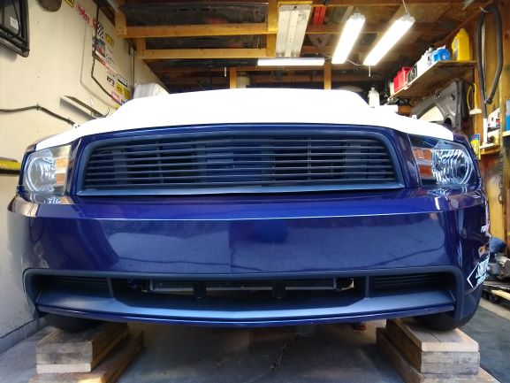

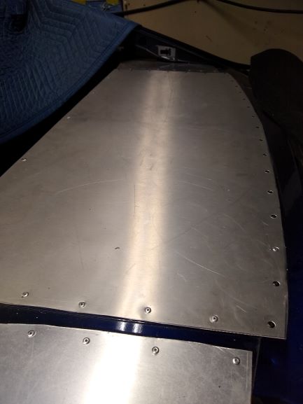

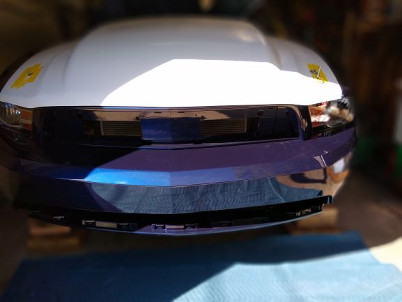

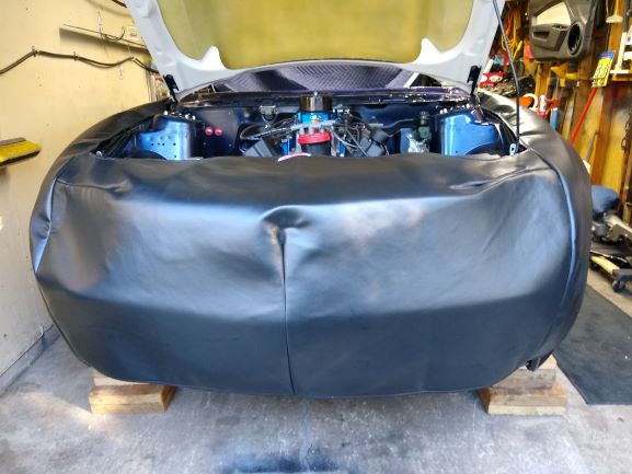

Covered up the package tray with some .032 aluminum, that finished the trunk, other than wiring. put the hood on and drilled for the hood pins. installed the bumper cover, upper and lower grilles. installed the snaps for my "Classic Coverall" from MJ Quinn @ Derby City Covers, and attached it to prevent damage while working under the hood.
ID:	56531   Click image for larger version
ID:	56532   Click image for larger version
Name:	Classic Coverall.jpg

Thanks Jerry all of my boxes that I made use six 5/16 bolts for the top. I wonder why NHRA deleted the drawing? The drawing gives everyone a road map for a safe weight box.

Larry, it was in the 2002 rule book, I am missing the 2003, it isn't in the 2004 , so either 2002 or 2003 must have been the last time it was in there.
I suppose that weight boxes started showing up in many different shapes and sizes.
They decided to just go with what looks reasonable.
A dozen 1/4 x 20 bolts would probably work , but too much hassle.
