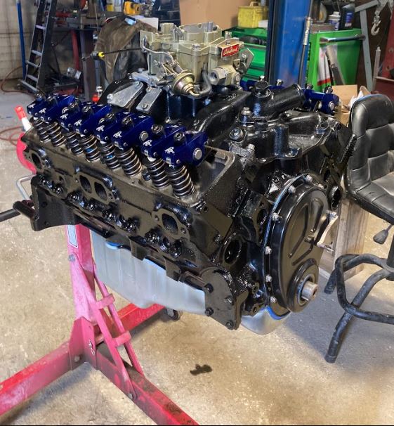

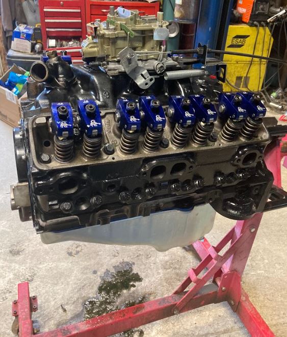

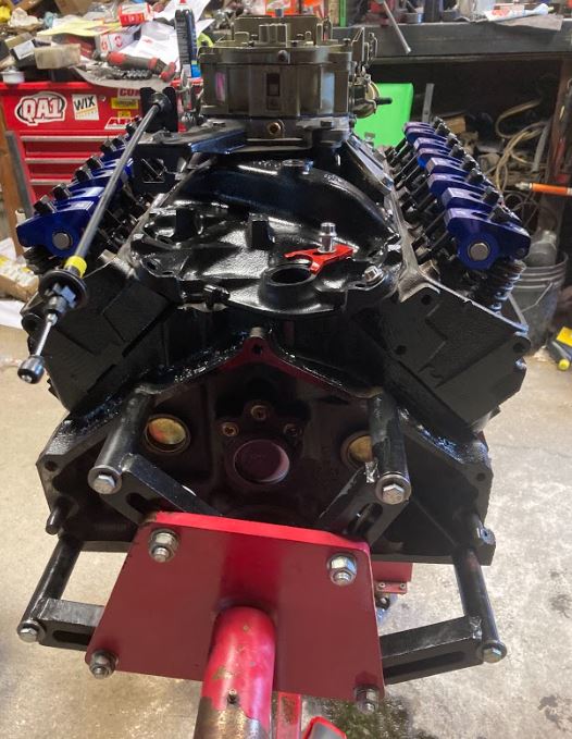

Hey guys,
Another long break. Took a long time to get the heads and intake back from the machinist(I really don't think they enjoy us stockers! haha) however we are pretty happy with our turn out.
Cam is installed and sitting at .045" intake and .110" exhaust for piston to valve clearance. For our first build of this type whats your thoughts on the intake clearance? Not looking to break any records and will have a 1000 other bugs to worry about but we feel it is just about right.
Assembled below and we should be seeing this sitting in the car in the next few days!

It looks first class.

Originally Posted by J518 View Post
Hey guys,
Might want to retard the cam two degrees to give you more clearance on the intake valve side.

Glenn,
Sorry left out some key enough. We did retard the cam two degrees and it gained us about .007” on the intake clearance. Putting us at the .045” mentioned above.

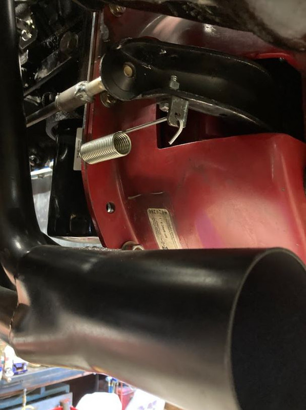

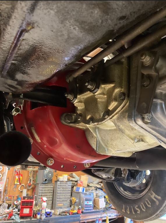

Really big week for my dad as he was able to get the engine set in place. Bellhousing, clutch, throwout bearing, starter, radiator hoses, modifications to fit the clutch fork, etc. done.
Pretty monumental for us to see the engine in place, this obviously adds fuel to the fire.

Congrats on the build, you should RE READ the advice Glenn B. gave you,…if this is a dish combo ,45 thou is not enough clearance. I would invest in a soft touch for the water…down the road you might consider custom head gaskets for more valve clearance…just trying to save you guys some $$ and aggravation ….
