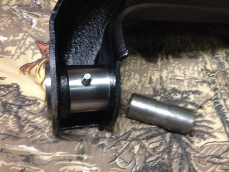

J&S Racing
Join Date: Sep 2013
Posts: 283
Likes: 102
Liked 319 Times in 82 Posts
Default Re: front end 69 nova
Name:	IMG_1534 (800x600).jpg
Name:	IMG_1535 (800x600).jpg
Did the install on mine today. Overall not that bad.
