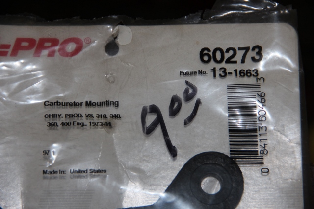

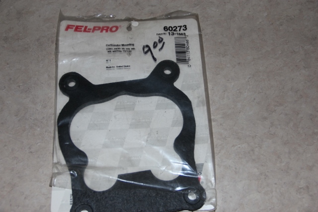

Bought theses off Mike Keown many years ago. They are 1/4 inch thick
Name:	Carb Base Gasket 028 (640x427).jpg
ID:	30140   Click image for larger version
Name:	Carb Base Gasket 027 (640x427).jpg

Jeff, I think that open style gasket is OK for a open plenum intake manifold,, but on a stocker cast manifold, it should be a 4 hole , shouldn't ?
boxmotorsports is offline   Reply With Quote
Old 08-18-2015, 03:13 PM   #10
njk53
Join Date: Jul 2007
Location: East China, MI
Posts: 504
Default Re: Q jet base gaskets
For what its worth, several years ago we tested with the open gasket vs. the 4 hole gasket on the dyno and the 4 hole gasket made slightly more power and torque with our combination.
