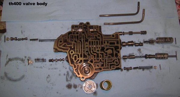

Like Mark said just block the 3-2 downshift valve.
Small valve at bottom right of photo .
I use a piece of 3/16" brake tubing ,about7/8" long , file it for a final fit .
Been doing this for years ,works great .
Thanks guys.......in this view is the mod present? Where is the tubing?

Sorry ,been off line for a while ,Damn Work ! No it is not shown in the picture . You substitute it in place of the spring .
When I get home , I have a good picture of it I'll post.
