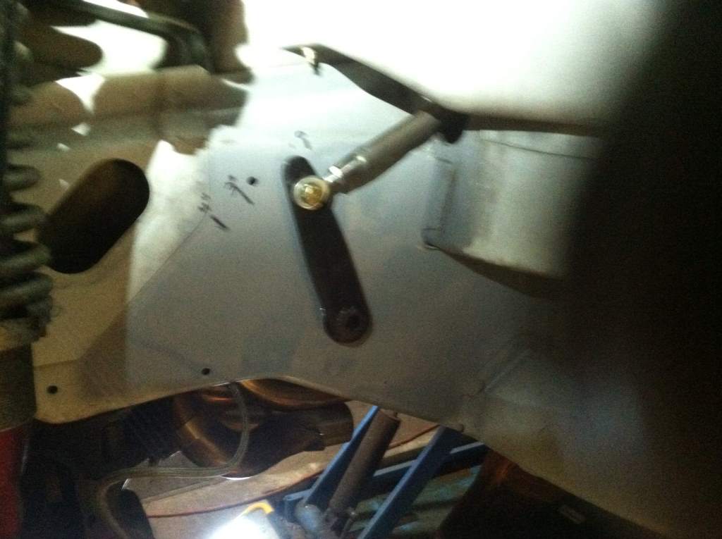

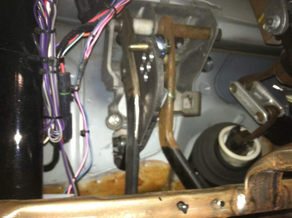

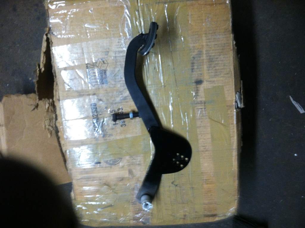

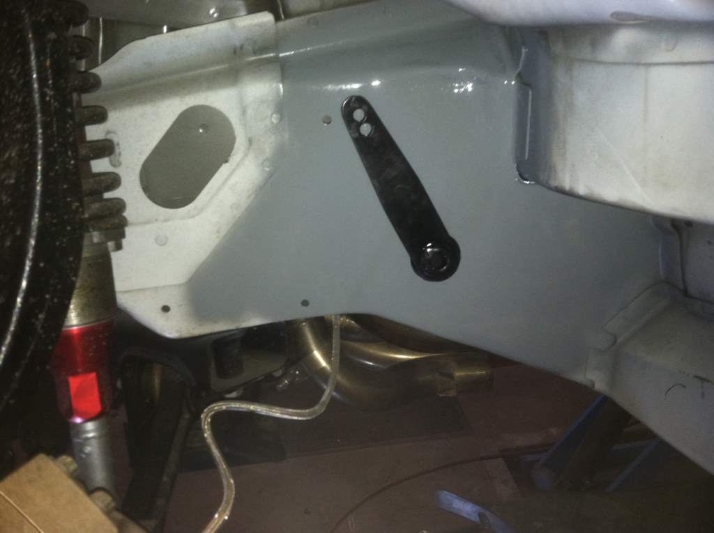

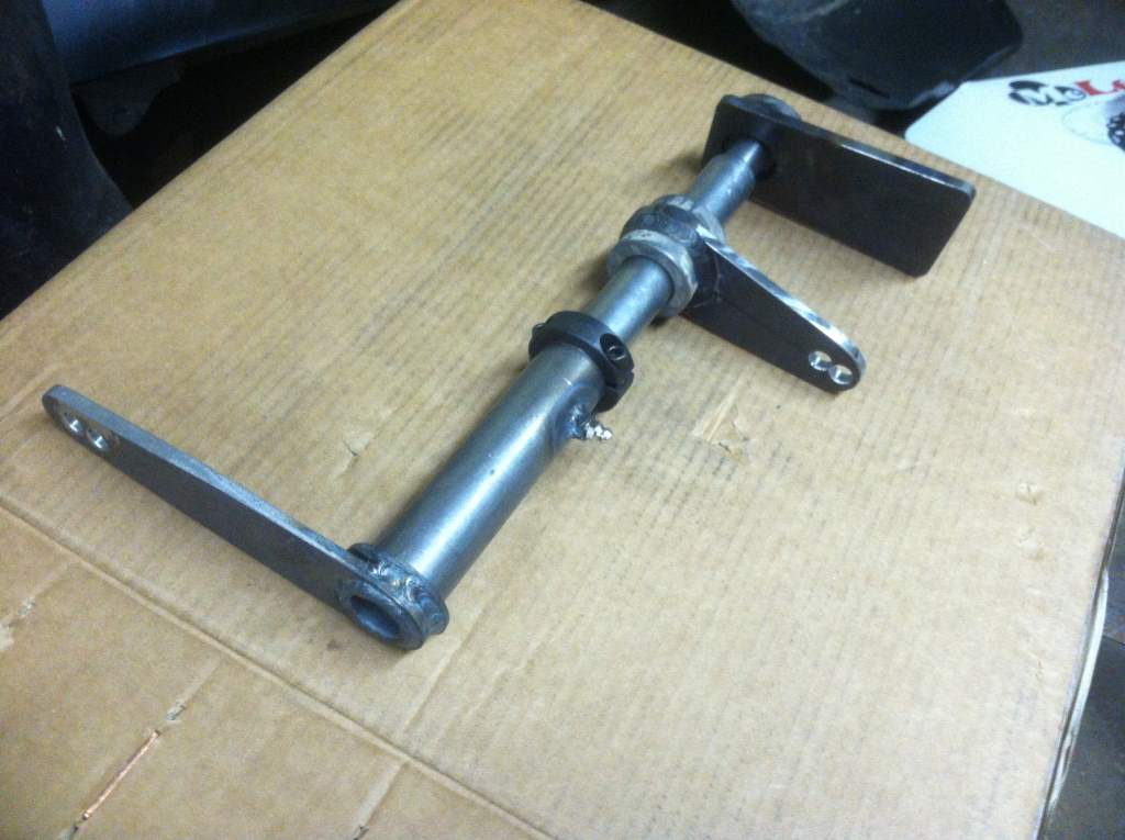

Originally Posted by JMan View Post
Hey Tom,
Would you consider selling me a Z-Bar for my Drag Pak? That would save me a bunch of time in design work.
Sorry for not responding sooner ,got a lot going on.
I really didn't make any final patterns of the clutch setup since it was refined over a few weeks of building.
Here are a few pictures to give you an idea of how I did Eric's DragPak.
The sleeve is bushed and is welded thru the frame rail and the supported at the bellhousing .
I'm looking for a better picture of the bellhousing end .
You will have to fabricate a custom shifter mount and longer linkages.
The left side of the tunnel will also need work to clear the linkage .
