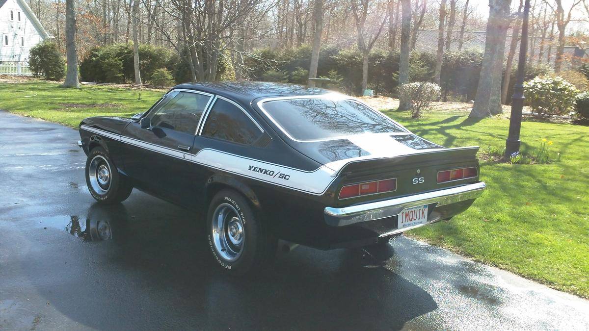

Can't wait for the Yenko Vega to get approved for AA/SA.
