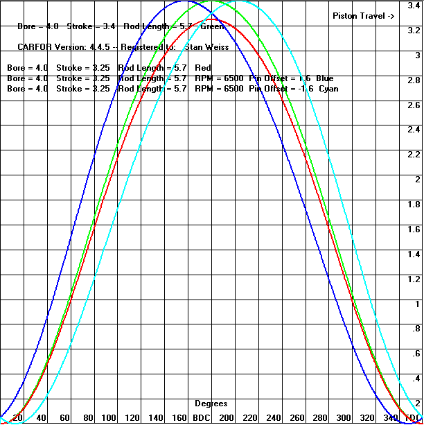

Old 09-02-2021, 07:05 AM   #28
Stan Weiss
Stan Weiss's Avatar
Join Date: Apr 2020
Location: Phila, PA
Posts: 797
Liked 735 Times in 386 Posts
Default Re: Spark Plug Heat ranges, what gains have you made?
When you add wrist pin offset a number of thinks happen. The piston and the crank rod journal are not ATDC and BBDC at the same time. Now based on which way you have the offset decides if piston TDC is before or after crank rod journal TDC. Another thing that happens is all 4 cycle are not long 90 degrees each. 2 become less and 2 become more. Again which 2 do what is based on where the offset was placed.The is also a very very small change in stroke and displacement. (For inline engines where you can move / offset the crank center line these can be larger).
Stan
Old 09-02-2021, 10:34 AM   #29
Greg Reimer 7376
Join Date: Nov 2008
Location: Glendora,Calif.
Posts: 1,137
Likes: 172
Liked 719 Times in 220 Posts
Cool Re: Spark Plug Heat ranges, what gains have you made?
In light of all this study of the laws of physics, what does the installation of an offset pin piston have on piston to valve clearance ? Sounds like a way to close up excessive clearance on one valve while opening it up on others. Or, like so many things out there, is it significant or just one more gnat to swat at?

Old 09-02-2021, 10:58 AM   #30
Stan Weiss
Stan Weiss's Avatar
Join Date: Apr 2020
Location: Phila, PA
Posts: 797
Within a normal range of piston pin offset the piston travel curve does not change very much from centered. So if you are using piston TDC there should be almost no difference in VTP clearance because of wrist pin offset.
Stan
PS Above I am talking about if you degree the cam. If someone just installs the cam dot to dot (crank rod journal TDC?) There will be more of a change in VTP clearance from the offset over centered pin.
Stan
