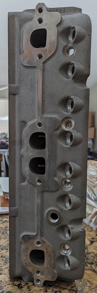

Hi Don,
The cylinder is not for my use. I was asked by several engine builders and cylinder head shops to help them find an aluminum casting as a substitute for the "not available" NHRA SBC-approved cylinder head.
I am actually a Ford guy and my new car is a Ford!
Anyone expecting new NHRA-approved cylinder heads from Edelbrock, is just wasting their time. I submitted many brands of 23-degree SBC heads to NHRA and they were rejected for one reason or another, with no sound basis for the rejection, including a cylinder head from TFS with an as-cast runner of 175cc. Let's be clear, this is for Super Stock class racing, not Stock class. You are allowed welding, epoxy, CNC machining and more.
The cylinder head I proposed to NHRA is a 23-degree cylinder head, available both for center and perimeter bolt valve covers. Profiler does not show the cylinder head in their catalog, however, it is available over the phone. The intake and exhaust ports are small, allowing them to be ported for many of the SBC engine variations with small ports and small valves. The chamber is already finished. This casting would be cost-effective for the racers since you can develop a port that will not require welding and/or epoxy. The casting is made in the USA from aerospace-grade aluminum and is thick everywhere; no more worries of leaking spring pads or cracks. Besides, in the event of a failure, it can be repaired.
The Profiler castings are currently available also. Lots of them as a matter of fact.
I have attached pictures of the cylinder head that was submitted and the brochure with the specifications of the cylinder head.

Let's pretend there are Edelbrock heads on the ground and everyone has them...
I spent lots of time with Edelbrock trying to get them to change a few things on the casting. There is ZERO reason that casting needs a 2.200 seat ring. It simply doesn't make a good head. Even with the 2.02 it leaves a .100 step at the seat/chamber transition! The throat is WAY too big. It's OK for a 2.02 valve, but marginal with a 1.94 and not even close for the 305 guys. The exhaust is decent but needs welded to be great, So at the end of the day the registers, the throats, the exhaust need welded up even before you start adding epoxy. Have $3000 in heads before you even look at port design.
Told Edelbrock all this.. They agreed to put a smaller OD seat ring in the next batch. THANKS! But it has to come out to fix the throats..
Now OEM.. I have a pallet of cracked heads here. Guys will simply not spend the money on OEM if aftermarket is legal. The last OEM I sent out to be brazed cost $1100 for the exhaust and then all the machine work to fix everything.
So this leads to the casting submitted.. $749 retail.. NO welding required. NO epoxy required. Makes a much nicer offering. That was the reasoning for choosing this casting. It's NOT an advantage to anyone. Guys are spending the money to get what's legal, ready to even use.
Like it or hate it, aftermarket heads are legal. Just trying for another option to maybe get more involved. Make a better offering. You do this when everything you tell a maker falls of deaf ears.
We weren't trying to reengineer the wheel here. We were just trying to legalize a casting that is cast with all the work being done to the Edelbrock. That's simply all..
