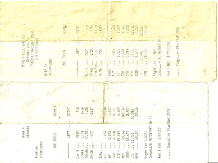

Warford's timeslips from Indy, stock 6.1 / stock cam/ working stock alternator, serpentine belt driven water pump
