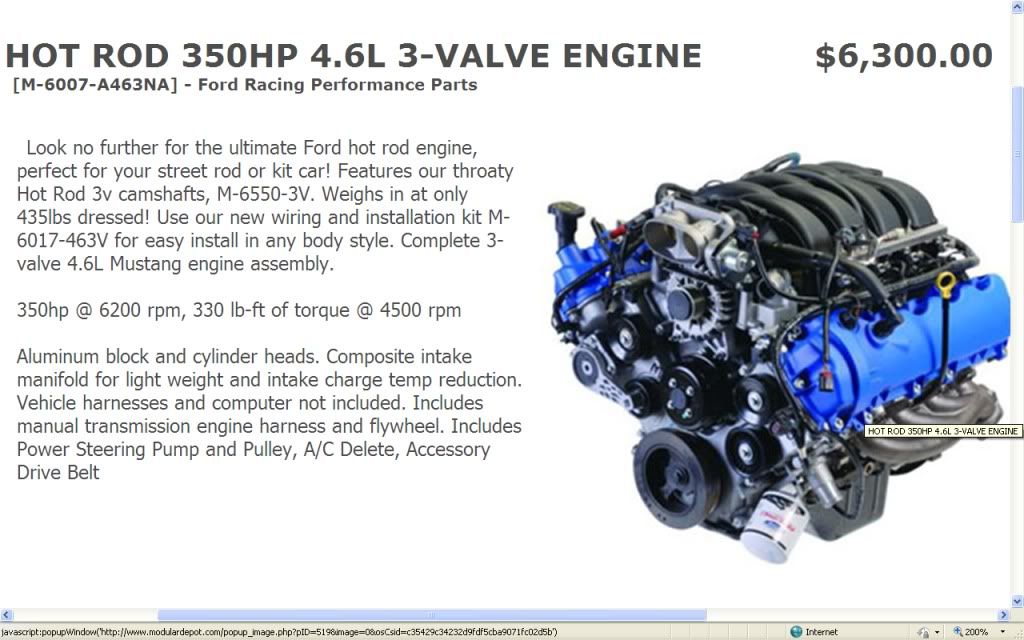

I went on Ford's site looking for the unique CJ parts.
Yes, it can add up quick. $ 950 hood, special grill. emblem and CJ gas cap. Not sure if the the front bumper cover is unique or not.
I found a dealer 3 hours from here showing they have the "Hot Rod 3V" crate engine.
Ford claims 350 hp from the engine, but also has removed the engine from their site.
If the "150 hp over factored hp" rule is close, then we would only need another 35 hp to get the car under index ? Just curious.

You can't use the heads, intake and throttle body form that hot rod motor. Those part numbers are not approved.
Look at the part numbers that are approved for the 2010 CJ 281.

You can't use the heads, intake and throttle body.
Charley:
You are correct sir.
After viewing the Ford site, we might just pass on this deal and wait till they approve the 2011 GT 5.0 for competition....lol
(edit; actually the throttle body, heads (cnc ported) and intake in the engine spec sheet are better than the ones on the 3v crate engine)

Default Re: 2010 Mustangs in NHRA classification guide...need help to i.d. one combo
The heads intake and throttle body are way better but they cost eight times as much. It would be a more cost effective motor if you could use factor top half parts. When the 5.0 motor gets approved (which it will) look for it to be rated somewhere around 250hp.
