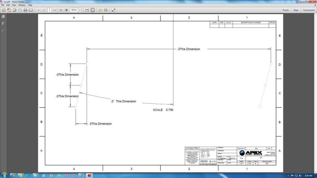

GTX John, I will get a schematic of the dimensions I need and post it here so you can see what dimensions I'm looking for. Schematic is now attached

Boy............ am I lost. I need some reference point to
start from and I will jig it up. Are we starting at the machined
areas on front and back of block where valley pan bolt down.
Can anybody explain the diagram to me?
I'm with you on that one... I thought I was the dumb one...
I have a complete 400 engine in my garage that I will do any measurements needed I just need to know where...... It also has the two piece valley pan and I have a spare one piece one.... I will ship it to you it that will help....

Okay, its funny how things can seem simple to you but not to others lol. Anyway, here is a picture of a valley pan to help connect the dots so to speak.
In the schematic I laid out the basic bolt layout of the valley pan and drew a line through the centers so as to indicate they sit on an angle. Imagine my schematic laid over the pic of the valley pan where the wholes line up with one another. This should make things more clear.
