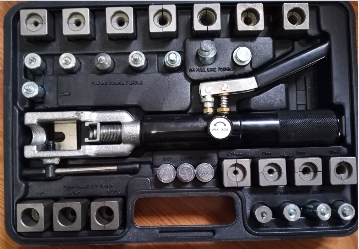

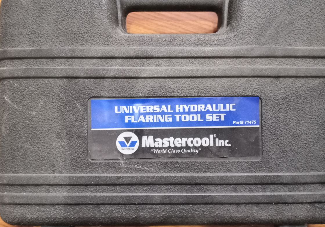

Brake lines are a pleasure with this.

Paul Precht is online now   Reply With Quote

Default Re: Advice on brake lines
have one on its way
David Lee is offline   Reply With Quote
