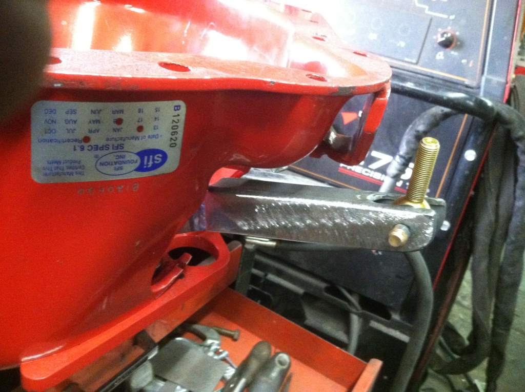

I made a custom fork using the inner part of the stock type fork for the one I built .
The basic location is ok. ....Just needs a little more length and a straighter line out of the bell and I prefer to have a direct link instead of a push pin.
These are MR2 Race Cars headers for the DragPak 360 shown in my previous pictures

great pictures. did you make the shifter aluminum mounting plate? I want to beef up
mind.
stock1080 is offline   Reply With Quote
Old 01-02-2018, 09:42 AM   #20
Tom Goldman
Tom Goldman's Avatar
Join Date: Jan 2003
Location: Allentown,PA
Posts: 2,479
Likes: 899
Liked 888 Times in 239 Posts
Default Re: Hydraulic Thow out bearing
mind.
Yes , 1/2" T6 . The picture was taken before I did the final trimming in front of the shifter . .... You don't realize how far back the driver placement is until you see stuff like the shifter.
